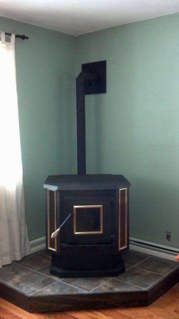

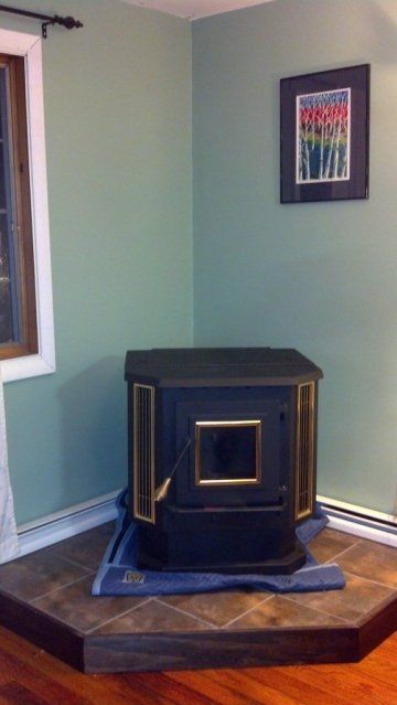

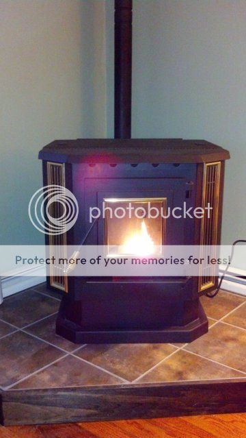

    Here is a pictorial thread of my first pellet stove build. Thank you to all who answered the many questions and assisted with great advice and tips.

    Time to stay warm!!!!

    Very nice! Enjoy the warmth

    Very nice hearth, where did you get it?

    Nice job, especially on the siding. J channel looks great.

    +1. Nice! Did you spray paint your vent pipe?

    Thanks for the compliment ... I made the hearth DIY style and about $80 in materials.

    Yes, I used black high temp paint for BBQ's. Looks glossy when wet but dries flat black.

    BTW, is there a good surge protector on that power cord?

    I sure do but it's only a 2000 J. I'll be on the look out for something a bit bigger in the future.

    nice! i love seeing one of my stoves in such a nice install. everything looks "by the book" to me scanning the pics.
