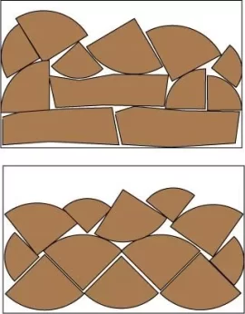

Sounds like you are running pretty normal john. The stove will have a spike of up to 750 or so, as it goes into full secondary bloom. You can mitigate this somewhat by the way the stove is loaded. Pack it tightly with wood, keeping the air gaps and passages to a minimum. Also maybe try larger splits.
