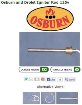

What type ignitor does the Osburn take?
Looks fairly standard but need to know the wattage and how long it is?
Here is one but I do not see the length and wattage
(broken link removed to http://www.stove-parts-unlimited.com/Osburn_and_Drolet_Pellet_Stove_Igniter_120v_p/44132.htm)

Dont have the lenght but here are the specs:
300 Watts
48 OHM / 2.5 AMP / 120 VAC

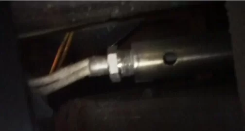

Hello
I will find out the serial # to see if it is threaded or slip on.
Today I worked on a 3 year old Osburn 45 MF Hybrid.
Are the bolts on the service door to the combustion blower phillips heads or what?
The only way to loosen them was to use my vice grip pliers on them!
Pic of 3 year old Osburn 45 MF Hybrid below has threaded ignitor. Does this mean most stoves have a threaded ignitor?
Also is there any way to remove that combi blower for servicing. It looks really hard to remove from the stove!
Ignitor type depends upon serial # (Threaded or not)
http://parts.osburn-mfg.com/replacement-parts.aspx?IdSite=3
model OP00045-2
HYBRID 45 PELLET STOVE -(SERIAL 1620-1744) 3644030PELLET STOVE IGNITER (THREADED)
Model OP00045-3
HYBRID 45 PELLET STOVE -(SERIAL 1745-2094) 3644132PELLET IGNITER 120 V WITH ALLEN SET SCREW
model OP00045-1
HYBRID 45 PELLET STOVE -(SERIAL# 0-1619) 3744030PELLET STOVE IGNITER (THREADED)1
