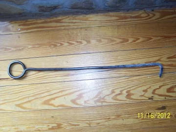

    Get yourself one of these or similar poker. Never a need to fret about where the wood wants to go.No need to open the front door on the stove. With this poker, I tell the wood where to go and if it does not, I move it.
    The tool is invaluable with any kind of wood burning. Length overall is 30 inches. No, I don't remember where I got it but any fire store should have it or similar.

    The ash issue is a flaw on an otherwise great stove, but not a major one. I have gotten so used to loading from the side that the idea of loading in the front never occurs to me, I only do that when starting from scratch. A good poker or one of those claw jammies at home depot and you should never have to reach in there at all, dont forget a good pair of welder's gloves.

    Got me one of those and welding gloves, I guess I am so used to loading my old stove via the front door that it will take more time adjusting to the side door. Was hoping someone had a good fix for the ash issue, looks like most have just learned to deal with it.
