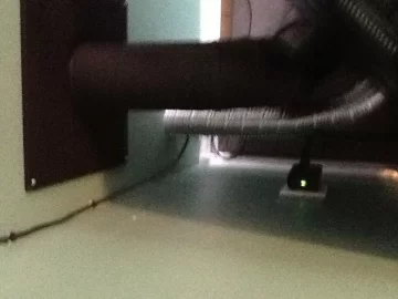

  18. Hoot23
    Hoot23
    Mar 28, 2012
    868
    129
    Alfred, Me
    Finally picked up the OAK and installed today. And while I was doing that, the wife and mother-in-law picked me up an iPad2 which I took this pic with. image.jpg
  19. CJ_starr
    CJ_starr
    New Member 2.
    Feb 1, 2013
    18
    4
    NH
    Looks good! An OAK and an iPad 2 all in one day? Great success!!! :)
