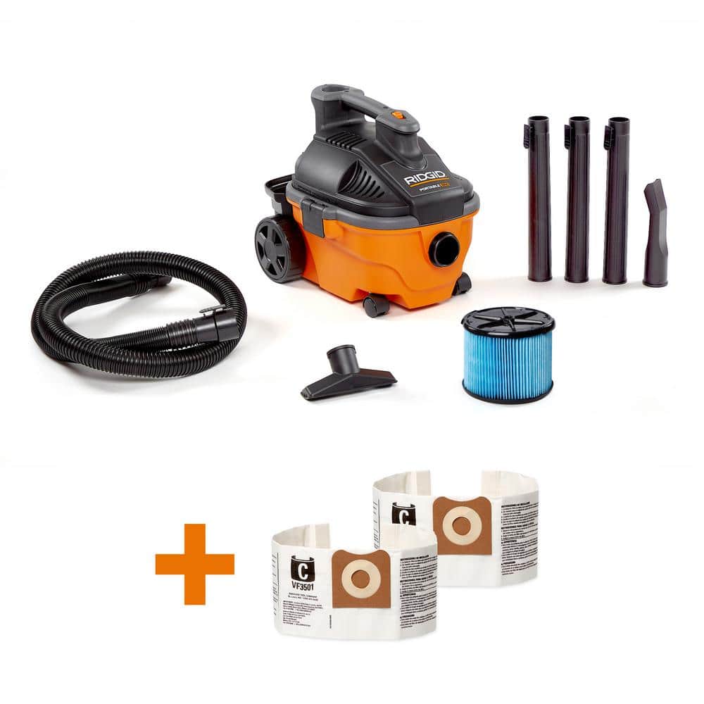

This is the vacuum I have been using since I bought the stove, I picked up some extra generic bags I found on amazon, that actually seem better made than the rigid ones. I change them once a year and use the air compressor to blow everything out at that time also.
I actually have a rigid one similar to that, maybe one size up in my garage. It's less than a year old. I think I will buy one just for the basement
and use it in the house for ash and drywall dust. My Canadian Tire has 2 models on sale. One is 4 gal and one is 8 gal. I can't decide if I want the extra size? I guess the bigger size would be better if I have water in the basement, but the larger size is overkill for an ash vac.I can get aftermarket filter bags on Amazon for both. Shop Vac brand seems to come with a bag and quite a few accessories. Also it says it has a 5 year replacement warranty at Crappy Tire
Just got back from Canadian Tire. Bought the 4 Gallon
Clearance price 109.99save $20
Limited Lifetime Warranty
In store 5 year exchange
Comes with tools and filters including a dust bag. I like the size and design. The hose size is small which is good.
