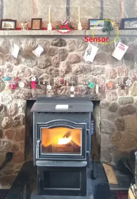

Just to clarify, did you change out the temperature pot or the Room/Stove/Off pot? Also, how about adding a picture of where your room temperature sensor is living? I love a good mystery:)

View attachment 288104 Thanks. In haste, I wasn’t clear. I always run the stove in room temp mode with dial turned all the way to the right which should have the distribution blower fan on its highest speed. Yes, the temperature setting is the POT I replaced. Thanks for your reply, Mark
In the drafty cabin I live in, the stove would keep the place in the low eighties if the sensor was in that location with the temperature dial set on ~65. Perhaps your insulation is vastly better than mine but the sensing device in the cable is at the tip and it its cooler down by your baseboard than the main area of the room it will work to get the baseboard area to the set temperature. I know you mentioned moving its position but it certainly looks to be the likely culprit to me.

I have tried the probe against the outside wall to the right in my picture and that position is where the sun comes up in the morning and it does affect the stoves performance. I’ve had the probe coiled there for a couple of years without this issue. The only draft could be from the kitchen door about 15 feet away and with it being winter in NE Pennsylvania we don’t dally around with the door being opened longer than it needs to be. I had thought about checking the resistance in the temperature probe but as an easy check I held it close to the stove while it was running and it quickly slowed the stove down.

Well SciGuy, I moved the probe to the left hand side of the stove. It’s still close to an outside wall but the sun doesn’t hit that spot. It’s been holding at a nice 72 for about three hours now. I’m cautiously optimistic but this is similar to yesterday afternoon but then the temp rose overnight.

My fingers are crossed too;) When I checked the temperature next to my base board after my last post it was about 6*F cooler than where my temperature sensor is located projecting out from the mantle. I suspect the difference is even greater the colder it is outside.
My sensor is poking out a few inches from the mantle in the area circled in yellow and yes those are bare studs in the background;)
