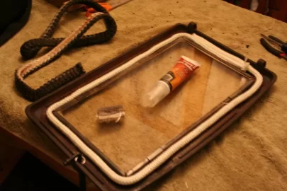

    OK, got the door handle taken care of, now on to the gasket.. I hope to get this done tonight.
    Door with new gasket laid out. I assume I cut off the excess?

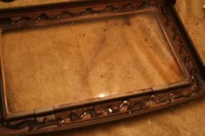

    Old gasket to the left, silicone on the glass, the old gasket "connector" on the glass.

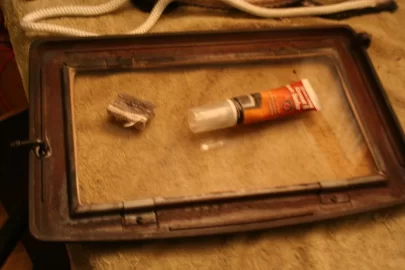

    Door scrubbed out & ready before install.
    Am I ready to roll?

    Hey Dix.
    Don't cut your gasket until the very end of the process...
    Once you have the groove cleaned of all the old gasket cement, run a damp paper towel or a rag all the way around to clean out any dust.
    Once that dries, run a small bead of gasket cement in the very bottom of the groove, & with your fingertip or a Q-tip or something that will fit in the groove, & spread the cement onto all the groove surfaces to prime them.
    Then run a 1/4" bead in the bottom of the groove & starting at the midway point BETWEEN the hinges, lay the gasket in the cement & press it into the groove. Work your way around the perimeter WITHOUT stretching the gasket. When you get to the start point, lay the gasket on top of the first end so you know EXACTLY where to make the next cut & cut the second end with a SHARP pair of scissors...Press the rest of the gasket into the groove making sure that the ends abut each other...Put the door on the stove & close it tightly. Let it sit for as long as is specified on the cement container, generally 3 - 4 hours...HTH

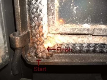

    Don't bother trying to reuse the connector, toss that. I started/ended my gasket replacements in the lower hinge corner. This way instead of trying to butt the ends together, I ended the finished end into the side of the started end. I believe I got that advice from Tom at CS, and was glad to have the help. When you cut the finish end, cut it about 3/4" too long, then pack it in tight against the side of the started end. Gives a great seal.
    Don't forget to readjust the latch tab on the stove. You want the door to be snug, but not oversight. With a lot of pressure on the door from the latch being overly tight, it can wear the portion of the door that the washers & latch swivel area spins against. Remember, the door is merely cast iron.

    Actually got the photos to load

    We always end the gasket between the hinges, as that is the tightest possible spot on the door. 3/4" too long seems a bit excessive, but if those methods have worked well for you, who am I to argue? Either way, Dix, you'll have a good seal when you're done. The main thing is to avoid stretching the gasket as you lay it in the groove.

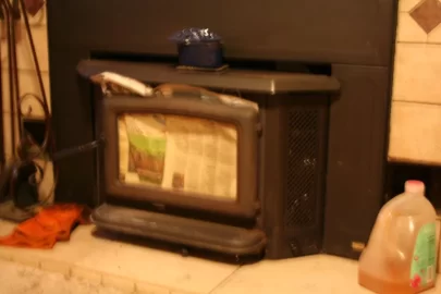

    OK, reinstalled the old gasket.
    Currently have the door reattached to the stove with news paper in between the door & the stove so the adhesive (what is that anyways?? it smells nice !!!), awaiting drying time.
