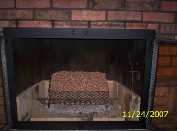

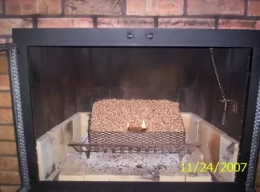

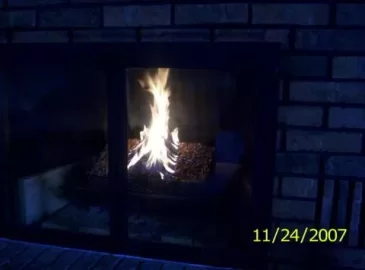

This is my little experiment this year. I installed some new air tight doors on my livingroom fireplace more for keeping the cold down drafts out, but still like an occasional fire every now and then. I saw some pellet baskets on the net and figured it might be a good idea for my fireplace. I didn't want to pay the $100 or more they were charging, so I had a local metal fab build me one for $40. It's just a basic basket made out of 13 gauge expanded metal that I sit right on top of the grate. It holds a max of 20 lbs of pellets and from start to ashes is about 6 hrs. It does put out some decent heat out my top fireplace vent.
  • [Hearth.com] PELLET BASKET

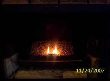

Some more pics. Sometimes it's hard to start and it tends to smoke for awhile til it all gets going. Still working on starting technique.

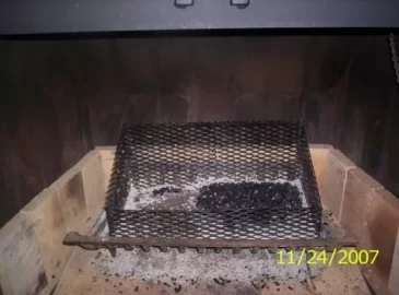

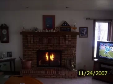

Full blaze and just about out after 6 hrs. I found reloading can be a major smoke out, unless you wait till there is just a little coals left, rake them to the front, then shovel new pellets behind. All in all it works pretty good and the wife likes the fact that there's less mess than wood. I was thinking about a wood insert there, but the stove in the basement keeps the whole house comfy, except windy below zero days. And if I light the basket it helps bring the upstairs up to temp and the stove will hold it from there on.

length 18" x width 10" x back hieght 8", front hieght 4"
It seems to light better and smoke less if I fill it half full, so maybe it's a little too big.

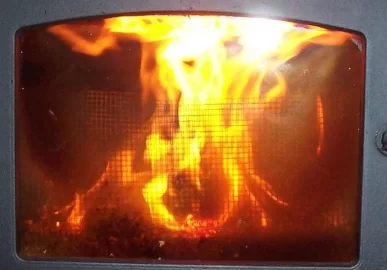

Tried the experiment in the stove this weekend. Created a bucket with double reinforced mesh wire. Pellets burned well in the stove reaching 500 degrees after 20 minutes. Bucket was empty after an hour. Will have to figure a good way to reload the bucket. Still not as good as cord wood and probably will not heat as efficiently, but iteresting.
