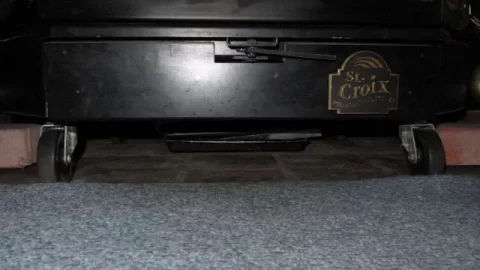

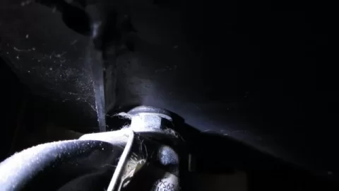

Hello ,Mark_ms What got me thinking about installing the wheels was when i picked it up from the local dealer ,as it was bolted fast to a shipping pallet ,as it turned out (see photo) the OEM had bolts threaded in to the bottom of the stove for transport (thanks st croix) W/pallet attached w/3/8" bolts.
So a short trip to TSC ,got some 3/8" diameter stem rubber wheeled casters that fit perfect.

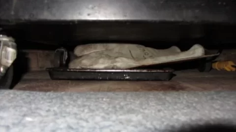

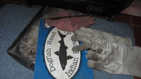

The cool thing about it, is that i put a large cookie sheet that holds a rag for glass cleaning ,gloves for well you know & cardboard to set my ash door on while emptying the ash drawers on the cookie sheet (photo 2)
Another bonus is i take it outside for a good cleaning.
But most important is that allows for access to repairs & maintenance for the stove.(note on photo 3 on R/S) i installed a plug disconnect for a number of reasons: 1st it allows me to keep a short pigtail as i hate long cords .2nd I do not have to fish the cord back through the moulding/wall.(that is a PITA).
As for installing your own wheels i would suggest welding casters that have the square mount type brackets on them, just figure the wheel diameter + clearance issues you may run into.
BTW I locked the casters stem w/3/8" nut.
Any other ? `s you have i will check back then. Hellfire,[Hearth.com] Pellet insert on rails/wheels[Hearth.com] Pellet insert on rails/wheels[Hearth.com] Pellet insert on rails/wheels
