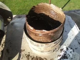

[Hearth.com] Pellet Insert Question [Hearth.com] Pellet Insert Question [Hearth.com] Pellet Insert Question Does anyone have an issue with water coming in the chimney between the liner and the cap assembly?
RTV is an option. If the pellet stove is on it may evaporate anyway.But if off i`d worry a little as it will follow that flex-pipe till it drips somewhere making a puddle where you may not want . Nothing should rot though.
Yea, pump it full of silicone. That far up there is no heat at all but if it makes you feel better, you can get 500 and 600 degree silicone at ACE Hardware and others. My termination cap fits directly into the flex where it is RTV'd and screwed in place, I do believe.

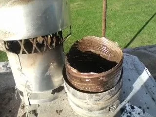

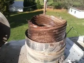

View attachment 79452 View attachment 79451 View attachment 79450 Does anyone have an issue with water coming in the chimney between the liner and the cap assembly?

wow why is there so much ash on the outside of that pipe, are u sure its not leaking somewhere else in your liner.. and thats a ton of ash u got there when i clean mine every ton 25 foot rise never seen it that dirty.
you can cut that liner flush and then tighten that up good and then silcone the heck out of it. and the plate.
is there another flue next to this it could be getting in there also

I agree ,That liner is a little long that is why you have ash buildup,IMO blowback from that small enclosed cap is not helping either.

What kind of cap would be better , this will only be my second winter with the pellet stove and i've had water issues every time it rains. It also makes the house smell like soot because of the dampness in the fireplace. Also the picture doesnt really show all of the cap,i'll post better pictures tomorrow.

You never even mentioned your vent length? As for Caps. I have seen several like that. They do fine.
You need to seal the gap with high temp silicone. That should stop all water problems.
As for the ash. Fly ash is common with all stoves. But Quads have copious amounts of air through the pot and produce more fly ash farther up in the system. The Mt. Vernon may push it farther than others (Santa Fe/Castille).

if you can do it yourself take and measure the width and length and cut that pipe flush and install a whole cap, something nice like copper which will weather good and go with your house. stainless is boring. if your all thumbs and its to hard for you
hire a certified chimney sweep not some clown who fixes stoves in a shed who reads a parts book and thinks they know something.
your sweep can order you something good like from copperfield, thats what i used to do.

The cap is not god awful, but it is functional i just feel that its not as open as a large square style ( it will also hood from water infiltration better) + the reason you see a lot of ash (which is normal by the way) is it hits the top of that cap & bounces back onto the end of your pipe. ----The style i speak of & also the one i have on mine is similar to this (it just feel it has more breathability too me) but like i said i would be more worried about the missing caulking----http://chimneylinerpro.com/products/HY%252dC-Black-Stainless-Steel-Single-Flue-Chimney-Cap.html
