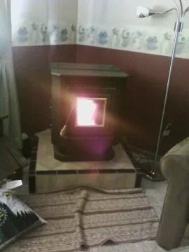

    Stove1.jpg Concrete is a wonderous material, my counters in my half way done kitchen remodel will probably be made out of it. But a slab the size you suggest @ 2 in. thick would weigh about 342 pounds, (150 # / cubic foot ), so take that into consideration before you start the project.
    I made my hearth (corner one as well) out of some 2/6's I had laying around, some durock, tile left over from foyer, and about a weekends worth of time. I will post pics when Iget home.
    Simply frame the lumber to your dimensions, (I had to take into account 2 baseboard heaters that were in the way), then U-Tube or Google "tile installation" and you should be in business! It's really a lot easier than it looks, and after it's done and your sitting in front of the fire, you get to say "I made that"!!! (which is what I say every time one of my kids does something good!!!!)
