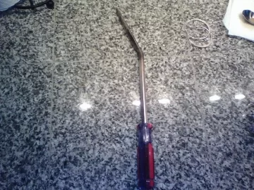

I wen't through many things. Finally went to lowes bought a 12" screwdriver and tweaked the blade to match the angle of the scraper, cost was about $7.
It keeps your hands away from the fire too...
  • [Hearth.com] Pellet Stove Scraper Tool Advice Needed
