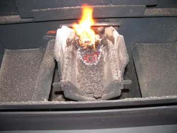

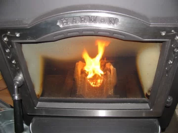

Here is a couple of pics of the flame and inside the fire box... I'm not sure but am wondering... If the feed rate is too low, like Tonyray, suggested, would that cause a build up of pellets and the ash to not be pushed off the burn pot?

Still learning how to get the best bang for my buck with the stove and keep it burning the most efficiently...
I'm surprise you haven't seen the 6 blinks on the panel. The flame looks weak so your probably getting low heat output. There appears to be an air fuel mixture issue. Do you clean the heat exchanger when you do your cleaning once a month? Bring the feed rate up to 4 and run in stove temp mode 4 or 5 for a while and see what happens. Can you create a stronger flame?
If this only occurs in a low burn situation, then I have to ask if you had the low voltage draft test when the unit was installed?
Looking at your manual, page 14 says that #2 is used generally for corn and #4 for pellets if you are room temp mode (on page 17, it says the same about stove temp mode). Although it does state that with pellets you can use any setting, I would think that 4 is for optimum burn. My ashpot isn't like yours and my Harman book says to test at slightly lower and slightly higher feed rates to get the ash lip at something like 1" from the edge of the pot. Obviously this isn't true of your stove, with the long-as lip, but if it were me, I would try a higher feed setting to help push the ash off.
The feed rate does not determine how many pellets you use, the temp (either room or stove temps). If you have the feed rate too low, then your stove will probably eat thru more pellets as the room/stove never gets to temp (or takes forever to do so), so there is no idle time. As usual, that is my understanding, and someone with more expertise than I may come in correct me.
I've seen it a couple times in the past and wasn't sure why it came up.. If I remember right when we ran it at 4, there was lots of unburnt pellets, but I'll try it again and see.. I'll kick it up to 3 1/2 and see what it does...
