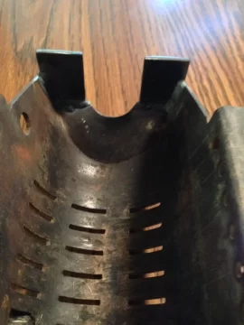

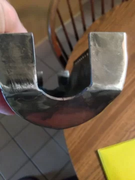

Or you can do this....I still get a little spillage mostly through the small space where the auger turns... [Hearth.com] Pellets not staying in the burn pot[Hearth.com] Pellets not staying in the burn pot

Not sure exactly what you did with the grate there, but it looks to me like the lip needs to be longer on the part that sits right under the chute where the pellets come out. I like the stove, but the engineering is very poor. There is a hook and tongue that sets the burn pot, but the rest of the pieces don't have a very positive fit. I was just interrupted from typing because my smoke alarm was going off. I had fire coming out of the exhaust port and the duravent T on the exhaust was cherry red.This is not a good situation. I take it back...I don't like the stove anymore. Pulling the pin on a fire extinguisher just changed my opinion.

I had a very similar situation occur with my M55 insert. It was totally my fault when I put the burn pot parts back in after a cleaning. I was not careful to insure the last piece was secure in place and the "lip" was actually slightly forward of the chute where the pellets descend.. Take a look at how you put the parts back in place. This might be a very simple fix. It was for me.
