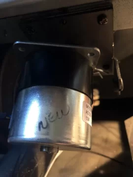

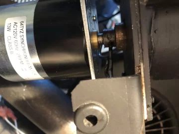

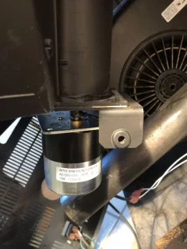

I have it apart no and I’m cleaning it. Here’s a couple pics of the new feed motor I put on.

your cotter pin is to far in.. It only needs to go as far as the first bump... It may be hitting a mount and causing the feed issue.. If i stuck min that far in on my stove it would hit

Ok I’ll move the cotter pin. Just finished cleaning the combistion blower and putting back on.
