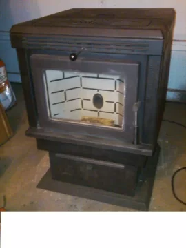

See pic of 3 year old newly painted stove below!

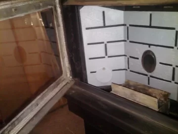

Thanks again for the tips and advice. I drove up and tested this thing out. First of all, the guy admittedly never cleaned it the whole time he had been running it. 5+ years or so, not even his vent. he said he took it apart and ash dumped EVERYWHERE. I verified that the auger ran and blower motor, bought it and left.
Cleaning it out today. In one of the pics above you can see a circle that covers a hole. its free swinging. The screw in that is broke off in the hole so I can leave it open or try to remove the screw and put a new one in. The holes it covers are FILLED with ash. The whole stove is filled with ash. I clean out my regular fireplace before it gets this ashy and I can stand up inside of it. About six inches of ashes were built up below the burn pot. One quote was "I have no idea if you have to keep the holes in the burn pot clean and clear or not, give it a try".
he also swore up and down it was 1800 BTU. I think my computer monitor puts off more than 1800 btu. I'm buying the vent, OAK and paint. I'm going to rehab this thing today. Any advice on the rusty inside components? They all have small bits of rust on them and I'd like to protect it from future rust.
