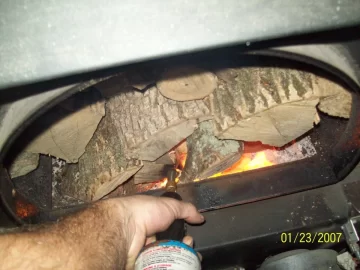

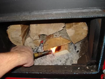

    As requested by HDRocker, I took some pics of starting a fire in the gasser. This is my daily process now that the weather is below freezing during the day and in the low 20s at night.
    I first run the turbulator handle up and down a few times to clean out the heat exchanger, being mindful of the last time I opened the cleanouts on the sides and vacuumed them out.

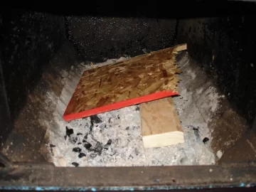

    Rake charcoal over the nozzle and place some kindling over that, with an airspace below so the OSB (gulp) can light easily.

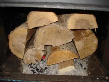

    Fill it up with splits, being sure there is a good half-round flat side down directly over the nozzle.

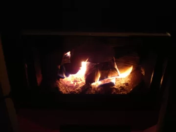

    Press "Start" to turn fan on and torch the kindling with the bypass CLOSED and locked at this point. Torch for about 20-30 seconds letting the fan pull the flame right into the kindling and charcoal pile.

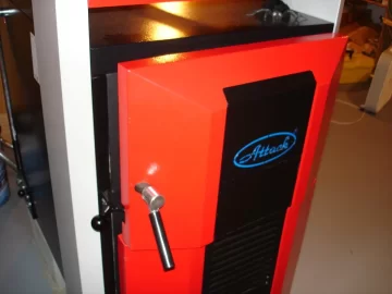

    Close the door against the CLOSED and locked down bypass latch, the door is not closed all the way, it's still open about an inch. Wait till you hear the rumble of secondary combustion. This should take about 3min. Look at spider boiler mascot keeping an eye on the boiler operator......
    After the rumble is established I open the bypass and watch the flue temp rise quickly to the 350 reigion, this takes about 2min at most. Once this happens, I close up the top door which also closes the bypass and I can hear the rumble of the secondary flame distinctly with everything closed up.
    The stack temp at full gasification about 20min into the burn.
    From torch to 250+ stack is usually about 25-30min. This whole process takes no longer than 10min. Tonight when I lit the boiler (water start temp of 104F) to pump launch at 160F was 16min. I burn one load as you saw in the second pic a day, when it's colder or I have a large demand for hot water and wish to re-load I wait for only coals (about 3 hours) rake them all over the nozzle and set my splits on that, this puts out heat almost instantly and really puts out the btu's.
    Hope this was helpful for you Rocker, other comments or suggestions are welcome, and expected. I'm by no means a seasoned gasser operator, in fact this is only my 60th or so fire in one, but it's down to a pretty good science I think.
    TS

    Hi Taylor, what's the secret on using that piece of OSB? 15/32"?

    I have no charcoal left at all in my firebox after the fire burns out - just a little bit of fine ash. Nice that it's burning everything, but makes starting the next fire a bit more challenging. That Attack is a sweet looking unit.

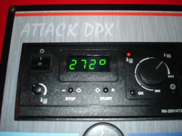

    What's that small knob on the bottom left of your controller do?

    You really load that thing up when you start it! I typically have about 1/3 of a firebox full, or less, when I start my unit. I've found that more wood actually makes my starts take longer. A few pieces, just enough to get gassification started and burn for an hour or so, is all I typically toss in.
    Your splits are also about double the size of my average split. Have you had any challenges with bridging?

    The little knob is the flue temp shutdown. It is either a room temp setpoint or flue setpoint (controller has to be set to know) This is when the flue drops below 210F (my personal likeing) it goes into "FUEL" and shuts down, this is what leaves me with the charcoal. One advantage to having a fan Maple (although I'm still jealous of your Varm).
    Stee: I don't have too much bridiging, although I processed this wood before I had a gasser, I generally process smaller, and will always now. I've found that with having the flat side of the split right over the nozzle it gets a great coal bed established and bridiging seems to not happen as often. This was a bit of a learning curve, but after all this Beech is burned up, my other wood is a bit smaller anyway.
    Marc: Thats 5/8" OSB........ love the engineered wood products and their wonderful ability to catch fire with just a torch! I have lots of building material scrap, as I'm the "wood guy" on all the job sites. "Fill up the back of my truck as long as it's not PT!!"

    Taylor, Have you tried putting the tourch up the nozzel? I have found the higher the shut down based on flue gas temp the more coals and if the fire box needs cleaning.I always fill the fire box cock full light it off. As long as the flu gas temp is climbing, iknow i am good to go.

    I basically light my EKO the same way except I shake out more gray ash and don't use any kindling (OSB or 2x4). My splits are 2 to 3 years dry and I pick out 3 or 4 smaller ones to lay on the coals and then load about the same amount as you do. I then light the charcoal from below through the nozzle and when I see the reflection of a good glow on the target bricks, I start the fan, close the door and close the bypass. Listen for rumble which is usually instantainous and walk away. I don't wait for any temperatures to rise. Usually check the gauges in an hour or so. The reason I start the fan before closing the door is that I have the fan speed turned down so low, it has very little starting touque and takes a while to get up to speed so I let the glowing coals have as much air as possible.

    I very rarely have a completely empty firebox and have a lot of charcoal to relight then throw in 3 -4 splits. Come back in 30 mins and add 5-6 more. Good to go for 8-10 hours.

    I allso fill to the top before lighting. It eliminates any smoke spillage. Usually gassing in just a couple of miniutes. boiler air adj and gasifacation 003.jpg

    Just the boiler water, 36 gallons I think. Older (10 years) Sony digital, I have played around with it alot though and enjoy taking pics of things on different settings.
    Woodmaster, I load it up for the same reason as you, no smoke spillage into house. Just enjoy the heat off the boiler!
