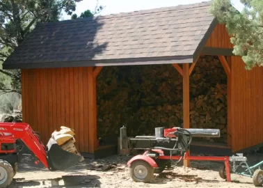

    Mine's 12' x 16', but one 6' x 8' corner's open and has no floor. The floored area's 144 ft², and I stack ~7' high, so theoretically it'd hold nearly 8 cords. I filled it in a "herringbone" pattern, and can pull wood from two directions. I'm not at all concerned about not having it sectioned off, because I don't put wood in the shed unless it's already seasoned. Some of those splits will probably still be in there when my daughter comes to clean this place out. Seasoning takes place elsewhere in stacks and heaps out in the open air. There's never anything in my shed that's not ready to burn. Rick

    Fossil, that is one nice looking shed that you have there, I saved this picture a while back for future reference; where did you get the plans for it? I am assuming that the open space is for your splitter. What type of wood is it made of? You mentioned being able to pull wood from two directions, does this mean that you have access through a back door that you are pulling from?

    No plans, I sketched it out until I got it to be what I wanted, then a builder friend and I and a couple of his carpenters just put it together (I had a LOT of help). In some cases as it was going up, we just designed as we went to get what we were after. The open space can be for the splitter, or just for easy covered access and hand splitting of kindling or too-big splits from the stack. The shed underpinnings and vertical supports are all pressure treated 4" x something's (floor joists are 2" x something's) posts and beams supported by pre-cast concrete deck post footers. The deck is 2" x 6" common SPF decking. The sides are 1" x 6" cedar fence boards. The decking and the siding is all generously spaced for airflow from beneath the deck (it's raised up off the sloping ground) and from all sides. No back or side doors...when I say I can pull wood from two directions, I'm just talking about the fact that when I stand in the open corner, I'm looking at ends of stacked splits to the "left" and to the "right", because of the way I decided to load it. Rick

    Gotcha, not bad w/o plans and building/designing on the go; if you do not mind, how much was the total investment?

    That shed is the cats ass.. Your friends can build one for me anytime!! I'll even supply the beer!! :)
