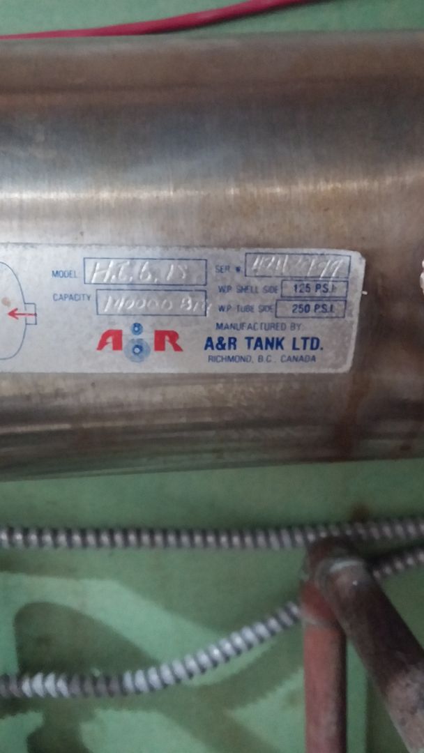

Its feeding a A&R H.I.G.1S , 140000 BTU heat exchanger.

The heat exchanger that is there is this one :

A&R is still around they made indirect tanks and HXers for some years back in the late 90's. They were more of a truck accessory stainless fabricator. Their tanks were fairly leak prone.
They probably have spec sheets somewhere to tell you what to expect at various flow rates and temperature differences.
Usually those tube HX required fairly high operating temperatures from the boiler to get even close to the rated output. I'd guess you need 12- 14 gpm at 180F supply to get much performance.

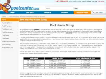

Typically for a covered, inground pool that size you want around 300,000 BTU, if you expect any recovery. I think you have about 1/2 the capacity you need, to raise the temperature or maintain it, depending on the cover, which makes a bi difference. When it's on :)
Location matters also, if it gets any wind, that will strip heat quickly. Fences or hedge rows help pools in windy areas.
Plenty of online pool sizing guides. It's an expensive hobby keeping pools warm. Sort of like heating the great outdoors.
