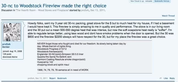

    Pro5oh
    You say the PH is too big and want to trade for a Fireview, but you already owned a Fireview which you say you made the right choice with back in 2011?
    Your signature indicated you have had the Progress since last February but your initial post in this Thread seems to indicate you just got it.
    Why did you ditch the Fireview??

    I noticed in your sig that you used to have a Fireview. Was this in the same house?
