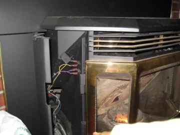

Hello Everybody,
We just started run our Quadra 1200i few days ago. The convension blower doesn't work as I expected. It seems starting very late (about 20 minutes after stove started) and it also stop occasionally during a session. We had some disscusion about this last year: https://www.hearth.com/econtent/index.php/forums/viewthread/11761/
I know the conversion blower is controlled by snap disc #1. The following is from the user manual
I have few questions:

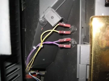

1. does that purple wired Snap Disc is the one on the photo?
2. Can I just short circule it by a wire and then it will not stop during a session?
3. "Power is always present at snap disc" means if I short circule it the blower will never stop even the stove has been stopped if the stove's power is still on?
thanks
