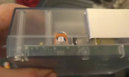

Thanks for the reply! Exactly what I needed to know. I've attached a pic of the control box, but there are no numbers. I guess clockwise raises it.... And a quarter turn? I'll try that.
  • [Hearth.com] Quadra new castille under performance
Should be a little V in the gray skirt, with the number in it

Indeed, there was a little V. Stove was at 6, moved it to the highest, 7 and it's running better! Thanks.
That is + 10% for a Santa Fe. Yours is #5 like I said above, but run it on what you want.kap
