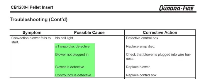

    ..... looked at your touble shooting chart (below) and from what you said above, it sounds like the convection blower isn't blowing away the heat of the stove ..... why it's not doing this may be answered by the suggestions on the chart .... with the stove unplugged try to turn the conv blower by hand to see if it turns freely without any resistance to turning, if it has difficulty, the bearings may be seized...... if it turns freely, (and if your comfortable working around electricity), bridge across #1 snap disc to see motor in the stalled condition picks up speed, would mean a bad contacting disc #1 contacts..... this is a start.....hp this helps .... cc

  5. jtp10181
    jtp10181
    Feb 26, 2007
    3,729
    3
    Madison, WI
    You sweep the vent and pull both blowers out and clean them once a week?
    CC might be on the right track though. The conv blower not running properly could be letting heat rise up more, heating up the hopper lid. Where if the blower was going properly it would blow all the heat out into the room.
