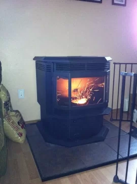

    Here is a pic of the fire the flame is down due to pellets dropping in. Was just wondering if those embers flying all over is normal for this stove. Or do I need to adjust something to cut it down.

    Thanks for the pic. It is normal to have some sparks flying, but if you have partially unburned pellets landing in the ash pan (Called the Popcorn Effect) then you need to cut down on the intake air with a damper. If there is no damper built into the stove, then you can add a damper onto the air intake on the back of the stove.
    What heat setting do you have it on?

    Looks like it's doing what it is supposed to. That is all just fly ash leaving the burn pot as new pellets drop in to it.

    Looks fine to me too, some pellets spark more than others. The fire looks a little on the low side if the stove is on high. What setting is this?

    Those are just the fines burning and getting blown out of the pot. It means you have good draft and all your holes are open in the burn pot. When you DON'T see them, then it's time to start checking for clogged holes (8 little ones) or restricted exhaust.

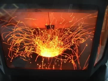

    [​IMG]

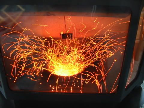

    Yes and Yes as to the fluctuations in flame height and also sparks.. Its a Quad. Nothing Burns like a Quad ;)
    Its a model of stove that gets slightly more air than other stoves to eject the ash from the pot. Helping to keep it good and clean with very little interjecting.
    Looks good... And slls has one of the best "Sparks" shots I have seen.... The only time I can get a BIG Show like that, is right at shutdown. Pellets dropping gives a nice show. But when its just stops dropping pellets and you give the clean out handle a little jiggle (dont open it! Just jiggle it :)) The last of the embers get thrown into the air stream :) Love it.

    The first image was actually on shut down. The pot gets cleared after every run cycle.
