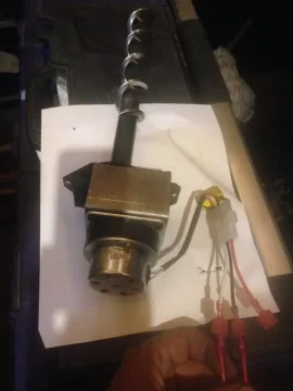

Well, I jumped the vacuum switch, and the Hi Limit switch and Feed motor still does not work. Then I pulled the auger and feed motor and put the AC test cord with the test molex connector on it.
See video - The feed motor works! so now what?
Hello
The key is that the red call light did not come on since the feed motor works!
Well I check all the wiring and then jumpered out the T-Stat terminals on the back of the stove. The red call light came on and the stove worked!

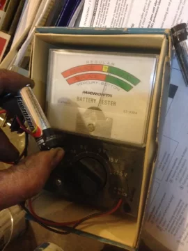

So I traced the T-Stat wiring and checked all the connections and they seemed fine. Then I pulled the T-Stat and though when was the last time I changed the batteries? I could not remember!
Pic 1 - Feed motor test with AC test cord and molex test connector

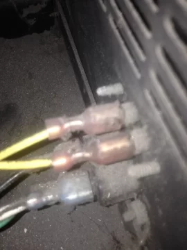

Pic 2 - Checked yellow T-Stat wires inside of stove

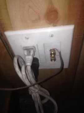

Pic 3 - T-Stat wires go to wall box connector
Pic 3 - T-Stat wires go to octagonal work box and the to T-Stat

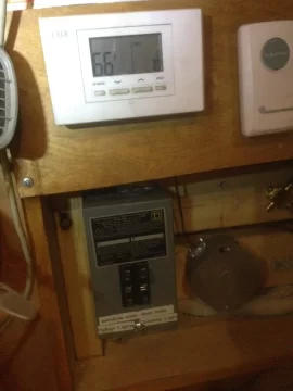

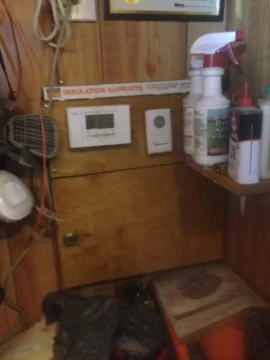

Pic 4 - T-Stat on wood circut box enclosure in shed

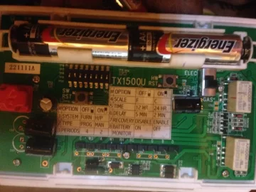

Pic 5 - Batteries in T-Stat
Pic 6 - Tester shows batteries are weak!

On a quad no call light tstat is always first check.The clear box has a procedure to test all motors and ignitor,bottom of second page.Glad you got it running.

Do you like the test connector? I wanted to try that too. LOL

Yea, that's a good SAFE way to test the motor! I like it. Beats sticking the two wires into the outlet! :)
