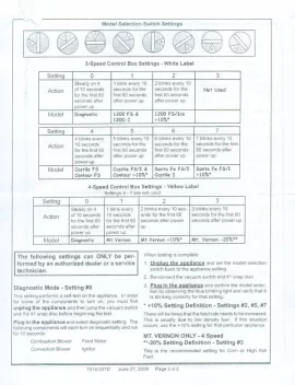

What did you set the dial to?

I have verified it is set correctly for Santa Fe.. 6 ..
You can tell its after market. Does Quadrafire make one or are they all after market. Its different than the one that came with it. The dial looks different.

No aftermarket boards are made for quads that i know of. Colors of the boxes have varied as updated products come out. The dial is just a newer model or diff supplier of switchs. Pantrol (the manufacturer for quad board) hold the proprietary rights to the boards and update software, speeds, timings, per quad. to keep the stove in compliance wit epa regs. So your feed rates are more than likely just newer settings.
