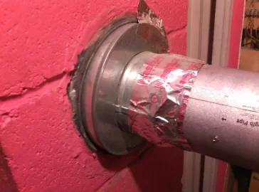

    I did something very similar. I went from a 4" pellet pipe into a 8"x8" block chimney. It takes a 4" to 8" pellet pipe adapter and then straight pipe that should go into the middle of the chimney.
    I did use an adjustable pipe on the horizontal to go the correct distance.
    See pic below. Click to Enlarge.
