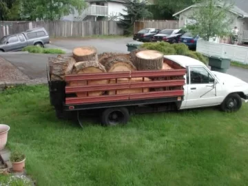

Ya know, if your looking for light weight side rails a couple (or 3) upright 2x4s for the stakes and use 1/2 plywood for the sides, you could bolt that together with carriage bolts and wing nuts pretty quick.
Log length on a 3/4 ton flatbed could easily be hauled much like I am doing in this picture on my small trailer. If you have a hard time getting heavy logs up t here then cut them into double or triple stove lengths
http://i77.photobucket.com/albums/j53/DannoSpider/Firewood 2008/DSCN0601.jpg
Elderthewelder said:
link dont work
Yeah, I edited the thing like 20 times. Hearth.com doesn't like photobuckt links when there is a space in it. Try coy and paste on whole thing, or try this link
http://tinyurl.com/6lc2oe2
Elder, the size of the logs in your avatar dwarfs the truck so much that it looks like a Matchstick truck trying to haul Lincoln Logs.
:lol:
Yeah, We grow our wood big out here in the Pacific Northwest. Those rounds are about 36" or so in dia, and are Doug Fir. Those are nothing compared to what our settles cut down out here using a axe
That is my little Toyota 1 Ton Dually with the rounds in it, truck has a little 22re 4 cylinder in it

Elder, you already know how cool that truck is, but I'll say it anyway. Thanks for sharing those pictures--that's one cutie-pie truck. And the wood is impressive, too.
