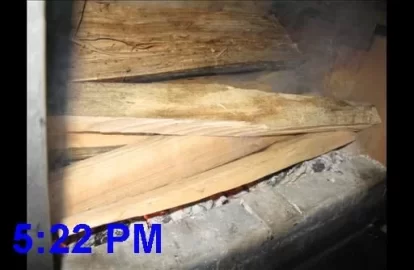

    Here is a pictorial of Raking coals forward and loading stove.
    Move your pointer over pic for pic name which is a description.

    Move your cursor over pic for pic name which describes the pics.
    Orange thermo is stove top , brown is pipe.
    the times are from the time stamp embedded in the pics
    I used a fire starter to help things along.
    Pics wont go in sequence in this post

    more pics
    Times taken off time stamp embedded in pic data.

    I empty almost everyday as it doesnt hold much but the ash pan is nice as it doesnt get ash dust all over the place. Not sure why it doesnt as the back is a litle open but there must be a little vacuum going on with the access plate open in the bottom of the stove and the flue still warm it must draw upwards thru that whole to keep the ash dust down if there is any.
    The coals and ashes you see is from 3 full loads.
    Here is more pics as this site isnt letting me post them very well.
    Stove got pretty hot at 31 minutes but closing the pipe damper cooled the stove top a little after these pics to around 750.
    Notice the stove pipe damper closed all the way in the pipe thermo pic. Thats why there isnt much secondaries going on as I was trying to cool it down some.

    I wanted to point out something on my pics. In the second post of pics you can see the little fire started I put in the kindling even tho the kindling was on hot coals.
    The fire started will get things going even fast as it burns the coals get air sucked thru them and the coals heat up much quicker. This adds to the burn even more.
    As this technique with the kindling is all about getting the heat up fast in the stove so you dont burn too much of the big stuff in the back for a longer burn time.
    Its like building your own burn chamber up in the top and front of the stove. Then it burns front to back.

    yes thats what dry small split oak does on hot coals and a fire starter to boot. I used to use lower quality poplar for kindling, doesnt give the same results.
    Plus might I add the back of the box is full up to the air tubes and the front and top is the only open air so the small area heats up quicker.
    Well looking back at the pics i could have got it a little fuller.
    Since making those pics I found out that stove top thermometer above 600 degrees is not in line with my infrared thermo but below 600 its pretty accurate. That stove wasnt getting too 900.
