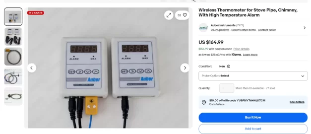

Does anyone have thoughts on remote flue pipe temperature measurement? Is it worth buying and installing equipment for this?
I'm thinking something like: https://www.ebay.com/itm/1114698900...258f8d&gclid=f8cd5fadd12f169b529836b9a4258f8d
I'm currently restoring my Quadrafire 4100i and will be installing a straight run of DuraVent DVL double wall straight to the roof. I cut a large portion of my steel firebox (or should I say, am cutting, it's about half done) in order to do my flue as a straight install. There will be minimum 18' of flue pipe between the stove exit and the top of the masonry chimney. The chimney is a large mason block style chimney with 8x12 clay tile liners. The chimney is mostly interior, 2' above the roof line.
I wonder, where would you route the cabling for hardware like this? Directly down the flue in the space between the duravent double wall and the insert? _g:ZZZ
This chimney gets a TON of draft, so I want to arm myself to safely operate this stove after all the effort I have put into bringing it back to life.

Sure, they're worth it. The prices appear to be lower on Auber's website. They have lots of different options as well. Basically you just drill whatever size hole the probe is through both walls of the DVL about 18 inches up from the stovetop. That is the highest temp reading usually. I'm using a magnet on a single wall, but I located the hottest spot with an IR thermometer.

Thanks for the input. Will buy direct from Auber. I'm on an eBay kick lately! Dangerous, I know.
