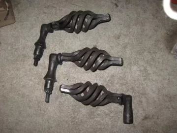

    VC Handles.jpg I
    I found the pic of the handles I fabed in the forge for my Olympic Crest VC knock-off
    would imagine any glue will be effected by the heat transfer from the stove so you may run into trouble there. If you go to the pre-epa forum and do a search for VC Defiant threads you will see pics of the bird cage handles I made for mine. I ran the same stove you have last year and did not like the junk wood handles so I fabed up some steel ones.

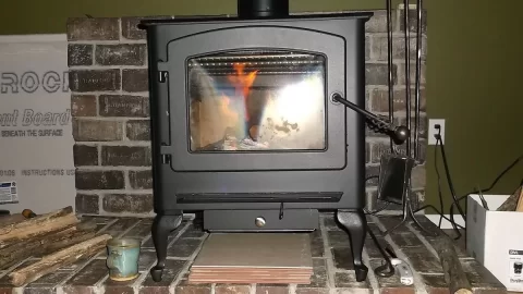

    They are very similar to the one I fabed for my new stove pictured here finished stove 009.JPG

    that looks great. Love the birdcage.
