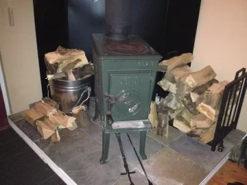

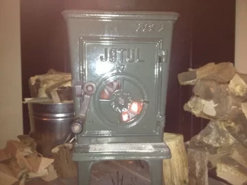

    Thank you,
    I'm having some difficulty uploading installation pictures. They are uploading sideways. I followed the recommendations regarding 2 inch clearances using double wall pipe once I broke through the roof. I have cathedral ceilings and used a cathedral ceiling support box.
    I used materials laying around the house to build the hearth. I never tiled before so my work is not professional but I'm happy with the outcome. Hearth cost less then $60 bucks to make.
    Hearth is built approx 4 inches off the ground, framed with wood and 3/4 plywood. Then finished off with slate tile. It doesn't get hot. I purchased a heat shield to protect my drywall and works great.
    During the off season I'll remove stove and compete my walls with stone.
    I do notice I'm constantly feeding the fire so I do not think the stove is efficient being 33 years old. It has been cold the past few nights (4 degrees). House has been nice and warm.

    Are you closing down the air supply once the fire is going? It should burn for 2-4 hrs that way.

    Usually no, I don't shut down the air supply b/c when I do that it seems to reduce the temp under 300 degrees.

    Sounds like the wood is not seasoned. If I left our air open the stove would be glowing cherry red. What happens if you try closing it half-way?

    Agree. The 602 seems more unforgiving of non seasoned wood. It does however work very wel l with bio bricks, line up 8 the long way packed tight with a little space between each four.
    Once going, turn down the air and close the flu damper, it should last a long time.
    If your wood is not seasoned and you have to use it, split it again and add it to hot fires only.

    The 602 will burn damp wood, but as the OP has found out, not without a lot of air and at a much lower temperature. Check that chimney for creosote build up after every cord of wood burned.

    Hello again, I've been burning a lot over the past 2 months. I'm trying to use only my stove to heat my house. I've learned a few things and I think you were all correct. My wood wasn't seasoned so that was effecting my burn tempuratures. It's been real cold the past few days and I'm burning through my wood pile. I am constantly feeding my 602. I'm not sure if it's just b/c its 7 degrees outside or if it's just not efficient. I can not get an overnight burn. My guess is that this stove is not designed for the overnight.
