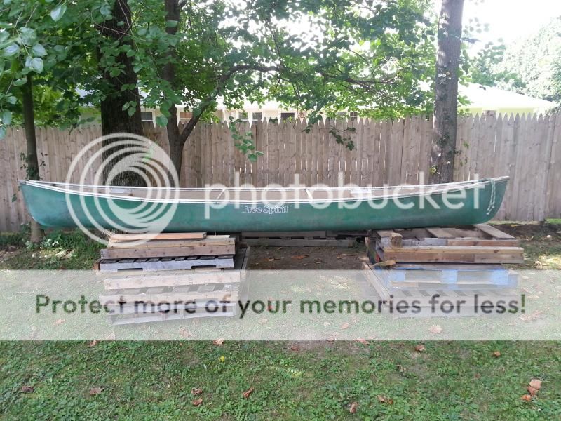

I've had an old canoe from Sears since I was a kid-it was given to our family by my uncle who had it and never used it. I inherited it from my dad when I bought a house between two big lakes and my wife and I did use it, but not as often as I'd like. Paddling on open water can be tough when there's even a slight breeze, and to get anywhere interesting it can take a while. So it sat for a while-until I got a free 3 HP Gamefisher outboard from my neighbor. It ran great, but I tore it down completely, cleaned out the carb, etc... The 16' x 3' canoe is rated for a 3HP motor and 4 people with a combined weight (gear included) of 750lbs, so the motor is a perfect match for a family of four with two small kids and a wife that tires of paddling quickly if the wind picks up
It should push us along at about four knots, which is plenty:
She's a little beat up and needs some reconditioning, plus I will be redoing the seats which were never comfortable to begin with, replacing the aluminum gunwales and thwarts with wood, and integrating a motor mount to the hull rather than just using a clamp on mount which I just don't trust:
These canoes were not top of the line models, but they work. Most of the canoes sold by Sears, Montgomery Ward, etc...in the late '70s/early '80s were made by a company called American Fiber-Lite, which churned out all kinds of stuff made from chopped fiberglass. Chopped glass is exactly what it sounds like, random fibers, chopped up, mixed with resin, and shot out of a spray gun onto a mold. The glass was then gel coated on the outside and painted on the inside. These canoes are sometimes known as "chopper gun" canoes. The main criticism is that they're heavy (this one probably weighs about 85lbs), and that the chopped construction is not as resistant to puncture compared to woven mat construction. I would not take this canoe out on the Upper Delaware for that reason. A collision with a rock that would dent an aluminum canoe or that a woven mat canoe would bounce off of would crack this canoe. It's not a concern as we won't be doing any river trips with this one-just tooling around the local lakes where there are no rocks to smash into at speed. However, many canoe aficionados will turn their noses up at boats like this one for those reasons. My thinking however, is that I paid nothing for it, I won't be putting much into it, and in the end I'll have a very functional little boat that will move my family around the lake with ease. Also, it's been a real pleasure working outside this summer-of course, this makes it even better:
