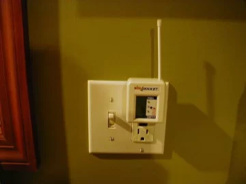

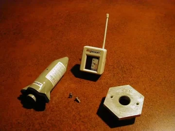

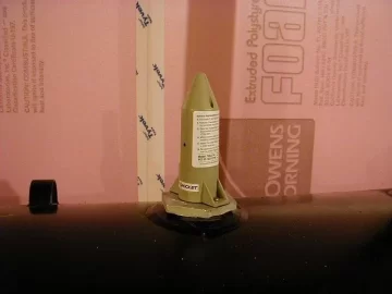

I just installed it.
One of the simpler things I've ever done: 15 minutes.
The meter seems to agree with the mechanical gauge.
The brochure says the transmitter will last 10+ years.
I have it plugged in behind the kitchen counter where it can be viewed easily.
Here are some pictures:
