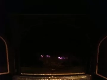

    So, third night in a row, I get the stove running beautifully... but only after three hours of fighting with it. We're currently cruising at 350F stovetop and 1000F on the cat probe, but getting there was no small feat.
    Set up a top-down fire tonight at 7pm, with four big splits of hardwood (guess I should've looked closer, but I'm assuming walnut), then some paper and fatwood, and then three small splits of pine. She took off great, and we went right up to 450'ish on the stovetop. 30 minutes later, it was clear my pine was going to be burned up before the big hardwood splits took off, so I added a small split of unidentified hardwood to the top. The fire almost immediately smothered.
    The next hour or more was spent cracking the door to get her going again, and then watching it die after I closed the door. Eventually, I got it to burn okay with the door shut, but we hovered forever below 400F stove top, and a fire too weak to bother engaging the cat.
    After two hours, I was able to engage the cat, but it hovered only around 500F on the cat probe for another hour. Three hours into the burn, the cat probe finally started climbing, along with the stove top. We got to 500F on the stovetop and 1080F on the cat, before finally lowering the air to cruise as intended.
    I assume the verdict is poorly seasoned wood, but would like a more experienced opinion than my own. If so, I can't imagine any solutions to this problem that aren't going to cost me more time than I have, right now.

    How big are these big hardwood splits? How long have they been split and stacked?
    Remember, the bigger you leave them, the longer they take the season. Within reason, leaving wood a bit smaller before seasoning, doesn't necessarily mean a shorter burn. It's easy to get caught up in the trap of believing that large pieces of wood are necessary for long burns. With a proper amount of draft from a good chimney setup, med sized splits won't burn down too fast on you.
    That said, if you are at all figuring your wood is the issue, then I hope you are taking measures now to be ready for next winter, and I suggest splitting these big pieces in 1/2 to help in the meantime.

    Splits were relatively average / medium. Two were perhaps one quarter of a 10" round x 20" long, and the other two were slabs off the sides of big rounds, perhaps 2" x 8" x 20". Unfortunately, they've only been split and stacked since last winter, perhaps 9 months. We just bought the house last fall, so we're ramping up the wood supply right now.
    I've had some trouble with the stove wanting to take off too hot when stuffed full of small splits, so I've been favoring medium to larger splits in the bottom of the box, with smaller stuff only top to get her started hot.
    Definitely! Already got 7 cords split and stacked in the last year, and another 6 cords in rounds waiting to be split later this month. I'll be in good shape, starting next year.
    I had never done top-down before a week ago, but burning on top of a coal bed always presented me with two challenges: 1. How to stuff a big load into the stove on top of a hot coal bed, and have it not go nuclear. You're getting the stuff on bottom burning first, and fire burns upwards fast! 2. Timing bed time. How long do you guys plan to burn that initial load? Are you talking just a 1 hour fire to reload, and maybe never getting to engage the cat, or is your initial load bigger?
    All good ideas. The wife has asked, "why don't we just use oil this year, and plan to be ready for next year with the wood supply?" Being as busy as I am right now, that's not an awful idea, either. But if I can find some way to burn this year, without sinking a lot of time into it, I still aim to do it.
    Been burning 35 years, but always in open fireplaces. This is my second year with this stove, but last year I had some seasoned wood left by the previous owner of this house. This year, I'm using the wood I CSS'd last year.
    Time is short, but I might consider buying kiln dried. Where do you find such a thing?
