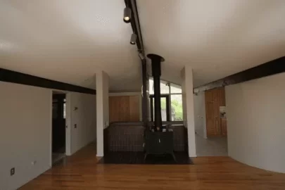

How many bricks are you loading the stove up with and at what point are you closing the bypass damper? What temp? Is the secondary air port on the lower side open (little side flap covering about a 3/4" hole)?
Also, can you describe the flue setup on the stove, from the stove up to the flue cap?
BeGreen, on cold start we we start with 2 bricks (the larger envi-blocks) and once they catch we add two more. Bypass damper is closed around 500F and secondary is fully open.
flue goes straight up to the ceiling cap. I am attaching a picture.

For starters, I'd get up on the roof and check the flue cap for clogging or at least take a good set of binoculars and examine it. It would help to know more about the flue. Is this 6 or 8", how tall is it from stove to flue cap? And last, try opening a nearby window or door and see if the stove perks up and has stronger flame.
Okay, waiting for the weather to get better (no rain or snow) before I get on the roof, but will do the inspection as soon as possible.
Flue is 8", and about 7.5-8 feet from stove top to the cap depending on where you measure (sloped ceiling).
