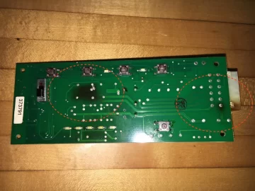

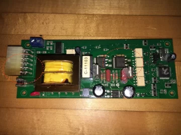

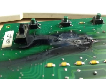

I turned my enviro empress turned off one day last week, and hours later I came back to to find the exhaust fan still running, the stove cold, and the board/switches non-responsive. I was hoping it was just the exhaust temp switch (or another switch) that needed replacing, but after looking at the board and trying to bypass that switch... I'm worried I am back at another control board replacement as the starting point, before finding more issues.
But given my level of happiness with this stove over the years (picky on pellets, just bought df okies most years if I had the choice) and the number of parts I've replaced over the years (most of them at least once, some twice)... I'm likely to call this the end of my experience with it and move onto a harman before next winter.
I've attached pics of the board, note the red circles. I tried disconnecting and bypassing the exhaust switch, without luck/fan-stopping. Any suggestions on other things to try? Or does it seem I'm at new board...
