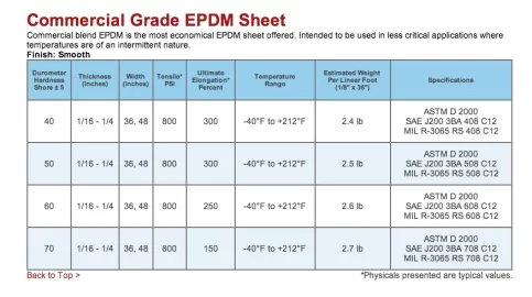

What grade do you have? This table is from one of the EPDM roofing manufacturers. Higher grades show 300F.
There are a bunch of old Chiles Power Systems in my area. I've worked on 3 that are 18 years old without any leaks. Plywood tank with EPDM liners. Many of the seals and gaskets in hydronic components are EPDM. usually they carry a 225F temperature rating.
