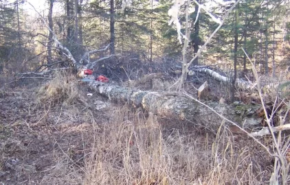

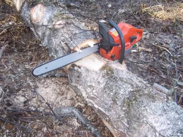

    Was cutting from the bottom up, almost made it.
    When the log fell the chain stopped NOW!
    Tried to pull but I could see, it ain't gonna budge.
    To heavy to move either end. & 20 miles from no-where.
    Now is when I'm glad I brought a back up saw.
    Not much of a saw but, it did the job. Limed the top & worked back to the stuck saw.
    36 year old craftsman saves the day :)

    Way to be prepared. When did that happen? I would expect you guys to have some snow by now.

    Today.
    No snow yet.
    Forecast for some this weekend, hoping they're wrong :)

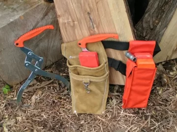

    Wedges are your friend.....I never go anywhere without at least 2.

    Thistle, I see you also have some log tongs. How long have you had them and how well do you like them?

    Has happened to me a few times. I get in a hurry or tired & want to get done.
    This one was the 1st tree so no excuses. Though the log was on solid ground but it was a tussock of frozen moss.
    No harm done, I just finished cleaning up the limbs, then went to the truck to get the back up saw.
    I didn't even get mad :)

    Since April & I like them very much.Much nicer on the back not having to bend over as often when moving lots of smaller rounds.Just grab & go.
