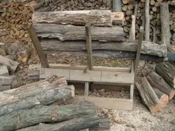

    Where I cut at I sometimes have to carry wood some distance to the truck so I try to cut stuff into lengths I can get on my shoulder and then buck them at home. The sawbucks I have made over the years are made so I can pull the logs off the truck right on to them and kinda a built in measuring with the 2 middle legs.
    Anyone got any better ideas? Dont get to fancy on me though cuz as you can see by my portable woodshed I kinda like to keep things cheap and simple.

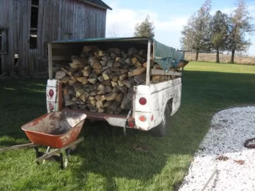

    Thats a pretty good load on the springs of that old PU trailor but it beats movin abunch of snow to get to the wood pile.

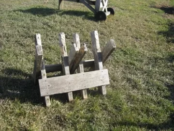

    Mine is similar, made out of recycled lumber.
    The legs are 20" apart.
    The horizontal braces are marked so I know where to cut on long pieces.
    I painted it with used motor oil so it will last awhile.

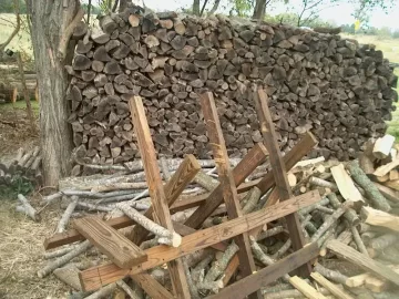

    Had a smaller sawbuck years ago from non treated lumber that eventually turned to compost.Dug through my odds & ends pile of salvaged treated 2 x 4's & 2 x 6's,built this in late July.The boards were 45" to 49" long,so the shorter ones were the X's,49" is total length. Marks from a Sharpie at 16" & 32".Some are warped & a little twisted,its hella stout though >> Sure wish I had this last year instead,much easier to cut & haul out 3 to 9 foot poles & buck them shorter at the processing/stacking areas than keep bending over,cutting short lengths & having to pick all of the pieces up then carry them to trailer or pickup.
