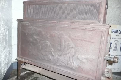

    For Simple who wanted a pic of the top chamber- let me know if you need another angle ?
    [​IMG]

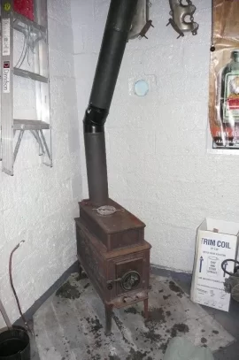

    Oh one more thing for Simpleman.... the vent outlet on the stove is 4.5" which I could not find so I used a 4"- secured it with a screw and sealed it with some stove cement and then I upped it to 6 " as shown in this pic.
    [​IMG]

    thanks for the pictures they are exactly what i was looking for. i wasn't sure exactly how the shelf was suppose to go in the stove, but i had it right. that is crazy that it exits at 4.5" i wonder why they would do something like that.
