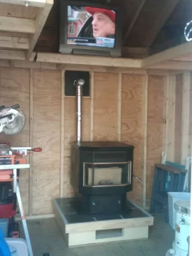

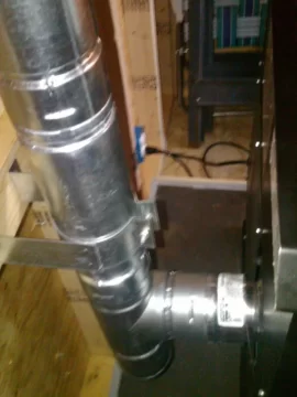

    Well, I finally got the Pelpro Bay View hooked up today in the shed after some real difficulty with the pellet stove appliance adapter!!
    See links below with more pics. Thanks
    https://www.hearth.com/econtent/index.php/forums/viewthread/88874/
    I am waiting for an "Open on Rise" Low Limit switch befor a fire it up. It does work!
    I saw it working before I bought it but still there were lots of problems!
    The Pelpro Bay View I got used and cheap so it needs a few things.
    I had to give it 2 coats of paint and new fire brick. Also lubricate the room blower bushing so it starts up fine.
    I also just learned that Aubuchon is the local Pelpro dealer but only their more busy "Service Stores" like the one in Nashua NH and Suncook NH according to the Haverhill store manager.
    I had to build a raised hearth but only had to buy 2 pieces of wood and grout and tile.
    All the other wood included the 1/4" PT plywood underneath it was left over scrap from the shed.

    Have to put on the finishing touches but atleast with pellet heat it will be warm cheap heat!!
    The kerosene heat for the shed was getting expensive!!!

    Wow that looks like one heck of a shed! Is that where the women of the house often sends you when she is upset ;)
  3. dw06
    dw06
    Member 2.
    Nov 15, 2010
    188
    9
    SW Pa
    TV check
    Pellet heat check
    Only thing missing is recliner & beer!
    Then it would be a man shed, a man shed I say :exclaim:

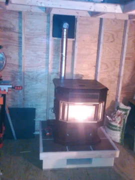

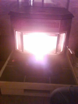

    Ok, I could not wait either so I manually bypassed the Low Limit Switch to get through the startup cycle. After that it burned fine!
    See pics

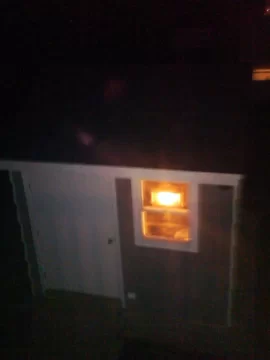

  14. Don2222
    Don2222
    Feb 1, 2010
    7,925
    483
    Salem NH
    Hello pelletizer
    Good question. I used PT 2x8x10s in the floor with 1-3/8" foil foam board for insulation. The floor joists are sitting on 8 solid concrete blocks. Under each block is a 2 foot deep hole filled with 3/4" stone! All the blocks are set at the same height using a Water Level!! No shimming or leveling was needed in building the shed on these blocks!
    The shed does not move!!
