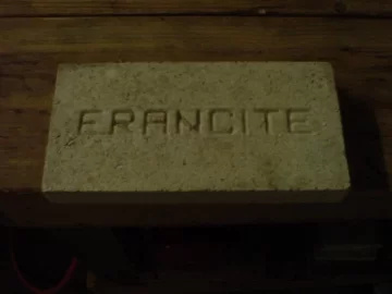

I have these Francite that were in the house when I moved in. Does anyone know if they are any good as spares? I have those cinderblock style as well in my Regency, which so far have held up fine, but these Francites seem heavier and better built. There was an old insert that I had removed here, I think they may have been spares for that.

Those look like ceramic type to me, not pumice. What type does your stove have? are the spare ones heavy?

I think my stove's are ceramic. These spares seem heavier though, probably because they are a little thicker than the ones in my stove now.
If there the same material, then it should be just fine. Pumice bricks are alot more grainy. Look like litttle concrete BB's stuck together...
If my college French holds up, francite is what we call bauxite. If so then they are ceramic.
