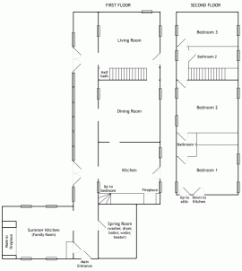

    Really depends upon the layout and the size of stove. For me, no. I need three stoves for whole house heating. And that would be the case even if this house was super insulated.
    I've attached my floor plan so you know where I am coming from. Your floor plan may not be as bad.

    For this type of setup I really think the soapstone stoves shine. The reason is the feel of the heat. If you stood next to a steel or cast stove and then a soapstone you would immediately notice a difference. There is truth to the "soft heat" that is described with soapstone stoves. Can you get roasted out? Yes, with any stove. However, I think much less of a problem with the soapstone stoves. This is one of the reasons we bought a soapstone and we've had steel and cast stoves in the past so we have something to compare to.
    The biggest problem is the size of the home and the small rooms. In our house we have a hallway that leads to bedrooms and bathroom. We used to always be cold in the far rooms and even had to run an electric heater before taking showers. That is in the past as we no longer have that problem. Most times we don't even use a fan but if the temperature drops below zero, we will set a small (6" blades) fan in the hallway, on the floor running on low speed and aimed toward the stove room. It is amazing how quickly those far rooms will warm by doing this.
    My best bet is that you will need to look at a stove that will not necessarily heat the entire home but will do most of the heating. For sure you would want a stove that will give you a decent overnight burn. This means looking at 2 cu ft minimum for the firebox.
