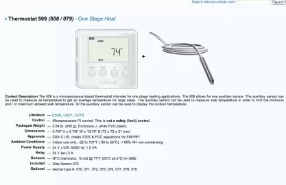

I am useing a tekmar 150 thermostat , not sure how it is all wired up tho.

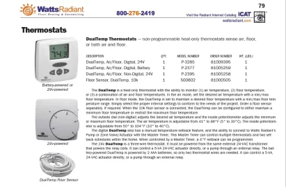

I like the tekmar 500 series. Watts Radiant and most of the other radiant companies offer dual stats. Install the sensor in a well, like a piece of 3/8" copper tube, as they do fail from time to time.
  • [Hearth.com] Slab sensor thermostat
in hot water said:
You might consider a thermostat that watches air and slab. It's real hard to control a radiant zone with just slab sensing. Unless it is a snowmelt.
hr
yes that is better than the RANCO
