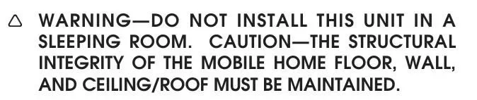

  6. SmokeyTheBear
    SmokeyTheBear
    Nov 10, 2008
    13,363
    1,663
    Standish, ME

    I do not think it is legal in most if not all areas to install in a bedroom

    smallest pellet stove aside from the red-neck window mount...is a Jamestown J1000, again...not to be installed in a sleeping room.
