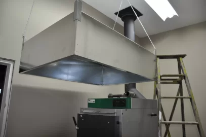

This is the one I had built the other day, there is an 8" flange on it and I plan on using a high cfm attic fan. Im not at startup point yet so not tested but i'm sure it will work good.
Huff
Looks good, mine was more a rectagular shape that went up to a funnel shape. But that should take out some smoke.

It just looks square in the pic. but its 3'x4'

Yes I thought about that and I think I will be fine . I Have a big window very close also a fresh air intake right under the front of my boiler. I dont like smoke at all and making sure I have a way to get rid of it.
