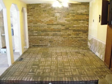

    i figure once the fire died down, like in the morning, the stone would still throw off some heat. i know it wouldn't be much. my one wood stove sits on a 10 foot by 10 foot pad of bricks. basically, the brick layer laid the entire floor with bricks and the wall is floor to ceiling also. that part of the house stays warm well into the morning with almost no fire going. the bricks soak up the heat, all 1200 of them. i wanted to see if i could do something close to that with the stove in the front of the house.

    wow, that is a lot of bricks

    holy moly, do you place furniture on the bricks or is the brick room dedicated only to the stove?

    yep, it's a ton bricks. literally. i don't own too much furniture. i have a small folding table i put up with a chair if i want to sit down and eat but i mostly put my wood there because it's easy to clean up. this was the dining room when i bought the house. i don't really dine and it's just me and the dog so now it's the wood stove room. i'm revamping the whole house so this room will be done in all knotty pine. it will look great when i'm done.

    the stove is in now?
    you drink dinner out of a straw?

    That is quite the room - I saw the picture too. Now, if you did that with soapstone it would be impressive as well (not to mention MUCH more expensive). Basically you have built up a very good thermal mass there. If it is an interior room then you are storing it very well and it will release into the house over time.
    There are folks who have done the math on how much heat can be stored in a slab of stone on the stove and frankly it isn't much in the scheme of things. 2000lbs of stone in the room is quite another matter though!
