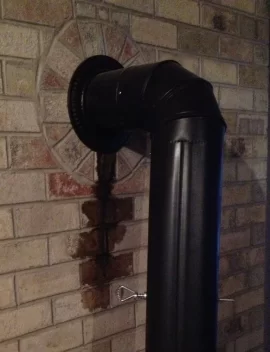

    I got home from work and found a blackish wet lookin stain coming down my brick profile from the bottom I my thimble. Anyone have any idea what it is and what's causing it?

    Have you recently had wind and rain? If so it appears that you have had water intrusion. Only other culprit is creosote. Slow dirty burns.

    Looks like glazed creosote that has turned to liquid creosote.
    If i saw that my stove would get shut down and the pipe would come off to be checked.

    I second the water in the chimney and washing creosote down into the house.

    Is that horizontal pipe section level, or at least sloped in the right direction? It's hard to tell from the pic, but it looks like it might be just slightly sloped. Sure looks like rain washed creosote or just soot to me. Even a relatively clean chimney might easily have just enough black stuff to get washed down and leak out the stovepipe, but as I understand, the pipe connections should be such that any water should not be able to leak out the connections unless there is a place for water to accumulate

    Your wood is higher for a EPA stove, but also what size is your flue? These stoves aren't like the old ones that put alot of heat up the chimney. If the flue is too large, the gasses can condense and what your seeing will occur. We had it happen to us, and drier wood and a chimney liner solved all our problems.

    The flue is 6" inside going to a 8x8 masonary on outside of house with a cap on top it hasn't rained here lately though unless hurricane sandy left some water in there somehow but I don't see how that could be considering I've burnt it a lot since then and it surely would evaporate. So I can't see how it could be water. When we put the black stove pipe through the wall I never sealed it with anything, should have I?

    Well....maybe, BUT it might have been a good thing that you didn't. Something needs to change. Obviously the fuel supply is suspect, but dumping into an 8 x 8 outside flue is going to AMPLIFY this problem.

    the pipe is stubbed into the 8 x 8. Stuff drips down the walls of the 8x8 hits the horizontal run and then drips in behind the thimble wall plate. Ooey gooey mess.

    There you go. Sounds right. It might also be some condensed water dripping down after the water vapor from the fire cools in the 8x8. Others here are much more expert on flues, but you might have to consider lining the masonry flue.
